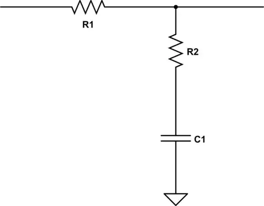

I'll assume you're asking about an RC low-pass filter like this:
schematic
I've drawn in the capacitor's ESR as R2.
The ESR contributes a zero at some high frequency. The result is the circuit becomes a resistive divider (you can also see this just from the simple "capacitors become shorts at high frequency" analysis), and the attenuation stops increasing above the zero frequency.
Whether this is "significant" depends entirely on what your requirements for the circuit are.
However it's likely that your capacitor (or the wires connecting to it) also has a parasitic series inductance (ESL). This will contribute yet another zero, leading to the filter having a high-pass characteristic at even higher frequencies. Again, whether this is significant depends entirely what your requirements are for the circuit.

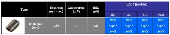

This is an "ultra low ESR, low ESL 1uF capacitor with ESR= 5 mΩ , ESL = 120pH.
This extremely low ESR is only in the Murata LLC series, which they compare to X7S series with 100 mΩ in a 4V rating shown in the table below. ( 20x higher))
Your question regarding 1 ns is better than Murata's "best cap" shown here with an ESRC=5ns . Smaller ESR's can be obtained with smaller value parts but not lower ESRC time constants. That requires a special dielectric and conductor design not commonly found in discrete parts unless in special microwave design or high voltage dielectric.

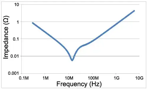

Note 120 picohenries is really small and dominate this discrete capacitor impedance above 10Mhz and ESL and capacitance determines the series resonant frequency. Smaller C values in shunt raise the resonant frequency and extend the low impedance bandwidth.
With more work and actually raising the ESR and lowering the Q, it is possible to eliminate the high Q parallel or anti-resonance as shown below.
