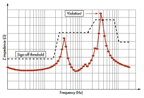

It all comes down to the frequency of interest. Here is a typical frequency response: frequency response You can see that the electrolytic capacitors have the worst performance. Generally they are used for decoupling at low frequencies (kHz range), i.e. They provide power until the supply can react.
Usually, I try to avoid them, unless you need 100uF or more. As to what is the best combination, that unfortunately depends on your requirements. You'll need to have an impedance spec. You can then select the appropriate capacitor combination. Something like this: impedance spec
Proper power integrity is a broad subject. As a general rule try to avoid using different capacitor values, as that can lead to resonance. See this app note. Pay particular attention to the plot on page 3.

  • The anti-resonance effects can be easily controlled by reducing Q of ceramic caps from Murata, where a small series ESR eliminates the spike in the spectrum, – Tony Stewart EE75 Nov 04 '16 at 20:59
  • @TonyStewart.EEsince'75 That may work for low frequencies, but it becomes increasingly more difficult as you go up. Firstly, decreasing the Q worsens your decoupling. The whole point of decoupling is to minimize the impedance, which you are not doing by decreasing the Q. Secondly, the traces, and the power planes introduce parasitics and resonance. Suppressing those, although not too hard, is not a trivial task. Finally, adding series resistance increases the trace length to the plane a lot. If you use a via in pad you get double the bandwidth than a 0.3mm via 0.1mm(edge) from the pad. – user110971 Nov 04 '16 at 21:15
  • @TonyStewart.EEsince'75 Also, you need to have access to the tools e.g. ANSYS. Furthermore, we are not talking about very high frequencies here. Around 10s of MHz. As I said in my answer, power integrity is a broad subject. – user110971 Nov 04 '16 at 21:18
  • Murata and TDK have free tools http://www.murata.com/~/media/webrenewal/tool/download/simsurfing/download/simsurfing413setup.ashx?la=en-us – Tony Stewart EE75 Nov 04 '16 at 21:31
  • If you do not understand what I say is true, read http://electronics.stackexchange.com/questions/264927/how-much-resistance-does-the-capacitor-itself-contribute-to-an-rc-circuit/264934#264934 – Tony Stewart EE75 Nov 04 '16 at 21:40
  • @TonyStewart.EEsince'75 True. In fact I prefer Murata for their extensive database of s-parameters. Unfortunately, the tools give a first approximation only. It all depends on the geometry of the planes, and the location of the capacitors e.g. How far away are the vias from the capacitor pads etc. For proper power integrity one needs to carry out FEM analysis. That is if you want to guarantee that the boards will work. Some companies do not carry this level of analysis, especially with microcontrollers. But FEM has a few advantages: software is cheaper, can work on the first run, pass EMC/FC. – user110971 Nov 04 '16 at 21:41
  • @TonyStewart.EEsince'75 I'll have to disagree with you here. Adding the series resistor will significantly increase the parasitic inductance. Currently, we are starting to use vias on pads because the 0.1mm trace length to the pad has too much inductance. Adding a new component will significantly worsen this. Look at slide 7 http://web.mst.edu/~jfan/slides/Archambeault1.pdf – user110971 Nov 04 '16 at 22:04
  • it's not a resistor rather, they add an oxide coating on the terminal, 0 ESL added.. – Tony Stewart EE75 Nov 04 '16 at 22:27
  • @TonyStewart.EEsince'75 oh right. That's interesting actually. I guess I'd be worried about the cost, and you get slightly higher impedance. You'd probably need to fine tune it for the situation. We have optimization programs that solve for a specific impedance profile with the minimum capacitors possible. I'll have a look at them for my next product. I've never used them before. – user110971 Nov 04 '16 at 22:34
  • If you understand the graphs I linked it simply removes the microwave spikes. similar when using ultra low ESR caps in low band 10Mhz but ideal is a ultra-thin dielectric between ground plane to power plane, for really low characteristic impedance. a square any size is a fixed L while C reduces with gap – Tony Stewart EE75 Nov 04 '16 at 22:36
