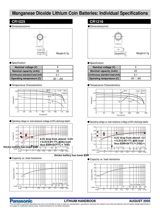

Your problem is not the ESR of the caps , rather it is the high ESR of the coin cell ( based on your previous questions)
Solution: Use a better battery such as CR123A with much lower ESR 3.00V <<1Ω ESR
Lithium primary cells have FAR more capacitance than electrolytic capacitors at same cost or size.
  • Load regulation error % drop in coin cell voltage = RL/(RL+ESR(bat)
Proof of ESR ( ignoring estimate tolerances from graph but for 50% SoC cell.)
Sample datasheet
  • Rule of Thumb
    • CR1025 has 30 mAh capacity at 0.1mA load and ESR of ~161 Ω
    • CR1216 has 25 mAh capacity at 0.1mA load and ESR of ~210 Ω
- thus Ah capacity is inverse to ESR of battery or mAh*ESR = constant - for given family for chemistry and supplier
  • exactly the SAME is true for any capacitor where ESR*C = constant
    • for any given family and similar size
    • but varies between internal chemistry, quality, supplier.
    • as cap or battery wears out ESR rises sharply and C drops sharply as mAh drops .
  • ESR*C < 1us for ultra-low ESR
  • ESR*C - 100us to >1 ms for general purpose alum electrolytic
  • ESR*C <0.01us for low ESR ceramic in small values.
