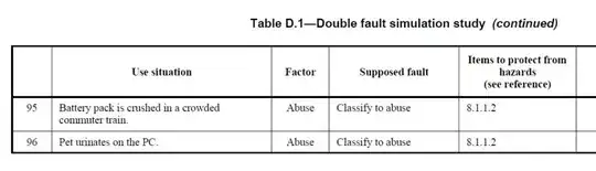

You may be surprised by the comprehensiveness of such analyses, e.g. below are 2 of 96 cases considered in IEEE 1625 2004, including the case that a pet urinates on the device (a PC). enter image description here
