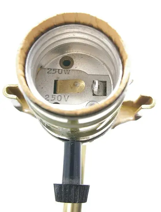

Why are the Edison screws allowed to be used? They seem unsafe. Why are they designed that way?
They require a complete grounding system to ground devices for the rare situation where the hot wires somehow touches the metal case of the device
While they let you use a lamp fixture which has an exposed hot contact when you remove the lamp, and nothing is there to protect your finger from touching it.
I would expect this socket to have a different design which will cover the contact from accidental touch.

    Why are they designed that way? They were designed earlier than 1910 near the birth of the electric light bulb. They had bigger things to worry about in those days than sticking your finger in the socket accidently - things like getting electricity to the home so they didn't have to use gas or kerosene lighting with open flames and the possibility of accumulating gas which could explode when you tried to light them.. – davidbak Jun 22 '16 at 17:46

The Edison lamp base design dates predates all twentieth-century safety regulations (because it predates the twentieth century altogether). Having light bulbs screw in and out is not great in environments where vibration is a problem, and replacing a bulb which has just burned out while in use may require use of a cloth to hold it, but it is generally advantageous to have a lamp which can be inserted or removed by handling the bulb rather than having to mess with the holder. Making a metal thread assembly that can mate reliably with a metal socket is easier than trying to mold threads into glass, and having one contact in the center of the socket is easier than trying to have two concentric contacts.
While I doubt the Edison base would be approved by any safety agency if it were being introduced as an entirely new product, it has been effectively "grandfathered in" because it has been used for a long time, people are familiar with it. A "safer" design that people aren't familiar with might lead to more accidents than the century-old design which, for all its imperfections, is well understood.

Today's sockets for incandescent or CFL lamps (and now some LED lamps) come with a black and a white wire. The white wire is neutral and is connected to the outer "threaded" part. The black (hot) wire goes to the center contact. I have checked this myself with an ohmmeter to prove it.
On the old 'Edison' sockets you have 2 brown wires. The light brown wire with ridges is the neutral, and connects to the threaded part of the socket, allowing a bulb to be replaced with no shock hazard. The other darker brown wire is the 'hot' wire to the center connector of the socket, coming from the light switch.
The socket is wired this way so that whilst screwing in a bulb the neutral makes contact first, and the neutral line should have just a few volts on it at most, depending on if it is a 'shared' circuit with other loads. All neutrals are grounded at the main breaker panel to keep the voltage low (<10vac) on the neutral wires even with active loads throughout a house, apartment, etc.
Touching the threaded part should not cause a shock - ever! If it does then the wires to the socket may have been reversed, either at the socket or the light switch for that socket. Even if it is a socket for a 3-way bulb, the threaded metal part is connected to neutral.
NOTE 1: A high wattage device such as a space heater far from the breaker panel could have 10vac on the neutral connection at the AC outlet, but 10vac is not a shock hazard even if you found a way to test if it is a shock hazard.
NOTE 2: Without a bulb screwed in and the power turned on, there is a 220vac shock hazard present. For European light sockets, it is 4 times the energy of American sockets running at 120vac if someone touches the center contact. Most light fixtures are above the reach of children, but not desk-top lamps. Best solution is to always keep a bulb screwed in-don't leave light sockets open.
For information on what constitutes a shock hazard in terms of neutral voltage, I found this article here.

    @passerby The question is about the exposed live contact when no bulb is fitted. I didn't downvote this, btw. – user57709 Jun 21 '16 at 23:35
    Yes, I'm not talking about the netural connection, I'm talking about the hot contact at the bottom , people can accidently touch it while replacing a bulb or leaving a socket without a bulb. – ronenfe Jun 21 '16 at 23:42
    @Sparky256 backstabbing? What? Lets calm down here. Your score on this question is currently +1 and -1, so 0. If someone partially up voted you, I'm guessing it means someone undid a down vote as far as I can see on the timeline. +10 -2 is the rep score, as down votes cost you 2 points but up votes give you 10. You're still 8 in the green. The reason someone down voted you is wholly up to them, and they don't have to comment or explain why. That's how SE is designed, and it's just a matter of fact here, you either grow a thicker skin or let it get to you. Make that +2 / -1 votes. – Passerby Jun 21 '16 at 23:42
    @RonenFestinger you should edit that into the question. And in that case, it's even simpler. The sockets are not meant to be changed or left empty, when the switch the socket is connected to is left on ON. But yea, legacy/grandfathered standards from a more carefree era. – Passerby Jun 21 '16 at 23:44

  1. Flaw: They require a complete grounding system to ground devices for the rare situation where the hot wires somehow touches the metal case of the device Mitigation: This is a one time cost, upon fixture installation. Magnitude of the cost is not that great, as it involves one extra wire in the cable.
  2. Flaw: While they let you use a lamp fixture which has an exposed hot contact when you remove the lamp, and nothing is there to protect your finger from touching it. Mitigation: Sparky's answer and user training do a great deal to eliminate this apparent flaw. It may appear that this is a dangerous design, but the facts don't really back it up. The Consumer Products Safety Commission evaluated electrocution deaths over a 7 year period from the last decade. They found only 25, 3-4 per year, were attributable to lighting equipment (https://www.cpsc.gov//PageFiles/108404/2008electrocutions.pdf). This does not mean that these 3-4 deaths would be prevented by a different fixture design, only it puts an upper limit on the risk from this design. My guess is that no one is killed by this design, because even it is wired incorrectly, it just gives you a small shock. Clearly though the risk is quite small.
  3. Flaw: I would expect this socket to have a different design which will cover the contact from accidental touch. Mitigation: It is only really an issue while the circuit is energize without a bulb present, so users have a sufficient work around. Again, the realized risk in this situation is diminishingly small.
