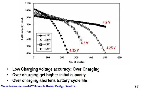

Contrary to urban myths of "damaged" batteries, the dependence of "battery service life" on charge voltage is a smooth continuous curve. Certainly the lifetime dependence ends at some point with catastrophic failure, but fears of 10 mV overcharging are grossly overstated. However, 100 mV over 4.35 V (for Li-Po battery) might cause a problem, see, for instance, this publication from Texas Instruments, page 3-5. enter image description here
So, overcharging of 150 mV over the nominal 4.2 V leads to about 10% more capacity for first 50-100 cycles, but the service life shrinks from 500-1000 cycles to about 200. Extrapolating, the another 100 mV will result in maybe 30-50 cycles life. This means that 50 mV over the spec won't kill the battery.

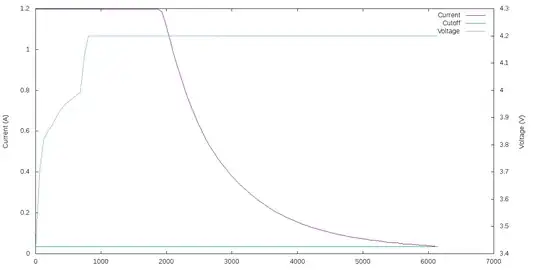

Here's the charge curve from a 1200mAh battery I charged the other day using my bench power supply:
As you can see most of the time it's waiting for the current to drop. The longer you wait with constant voltage the greater the capacity. I waited until exactly 0.03C.

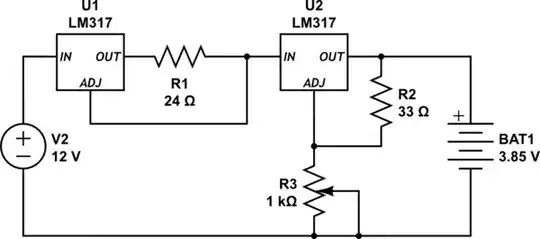

schematic
This is a simple constant current constant voltage design using 2 LM317. I have to build one myself because it's very hard to buy a 4.35V charger in the market. Circuit is over simplified, do remember to add the caps and protection diode.
Set the U2 output to 4.35V during no load using R3 pot before charging. At full charge it will not exceed 4.35V. Also do check the manufacturer spec on the battery, mine mention 4.35V +- 0.03V charging voltage.
