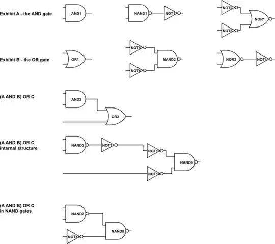

The most convenient form of amplifier for use in a gate - because it has high input impedance and useful voltage gain - happens to be inverting. This is true whether it is a BJT (common emitter) or FET (common source) amplifier.
Thus a gate formed of a single amplifier stage MUST have an inverting output - that means it can implement any of NAND, NOR, or NOT. (There are a very few exceptions, like ECL, whose lack of gain makes them very intolerant of voltage variations)
So if you look at an AND gate - or an OR - you will find a NAND followed by an inverter - or a NOR + inverter.
That makes AND not only more expensive and power-hungry than NAND, but also slower.
The fact that any combinational boolean expression can be rendered into sum-of-product form (AND then OR), and trivially transformed into NAND-NAND form simply by inverting all the intermediate signals (using DeMorgan to implement the OR function with NAND gates) makes a network of NAND gates incredibly attractive way of implementing it. (Ditto Product-of-Sums, using only NOR gates).
schematic
This shows how AND and OR gates can be implemented using either NAND or NOR technologies (Exhibits A and B).
It also shows how a simple expression in SOP form (A AND B) OR C would be implemented if you simply used AND and OR gates formed from NAND blocks.
Hopefully it's obvious that all you need to do is delete pairs of inverters to arrive at the final NAND circuit.
The result uses only 2 levels of gain instead of 4 if you used AND/OR, so for the price of a little extra thought, your logic is twice as fast.
    The "(A and B) or C" could in most processes be implemented more efficiently as by adding an inverter to the output of a 3-input gate which computes "not ((A and B) or C)". In CMOS, such a gate would take 6 transistors, plus two for the output inverter, or 8 total. Two four-input nand gates as you show would take 4 transistors each, plus two for the inverter, or ten total. – supercat Jan 17 '17 at 20:00
  • @supercat Indeed yes, if you can work below the discrete gate level, there are other options open to you. –  Jan 17 '17 at 23:04
  • Do you know of any common terminology to describe a single gate with an arbitrary combination of AND/OR logic followed by an inverter? If a process can support both an N-input NAND and an N-input NOR, any other combination of AND and OR with N inputs that are each used once should be likewise realizable for the same number of transistors. – supercat Jan 17 '17 at 23:15
  • Sorry, not that I know of. There seems to have been an attempt to drive more universal And/Or/Invert gates (7450, 7451) but that didn't seem to last. –  Jan 17 '17 at 23:24
