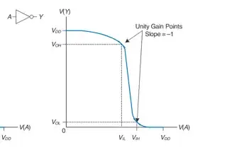

A real inverter changes more gradually between the extremes, as shown in Figure 2. When the input voltage V(A) is 0, the output voltage V(Y) = VDD. When V(A) = VDD, V(Y) = 0. However, the transition between these endpoints is smooth and may not be centered at exactly VDD/2. This raises the question of how to define the logic levels.A reasonable place to choose the logic levels is where the slope of the transfer characteristic dV(Y)/dV(A) is −1. These two points are called the unity gain points. Choosing logic levels at the unity gain points usually maximizes the noise margins. If VIL were reduced, VOH would only increase by a small amount. But if VIL were increased, VOH would drop precipitously.

diver and receiver
behavior of these two gates

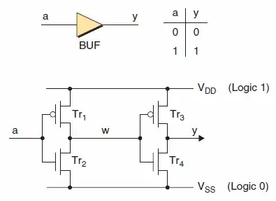

Suppose we would use not an inverter but a buffer. In all CMOS logic technologies (and that is 99.99% of what is used today) a buffer is made by cascading two inverters:
enter image description here Source
Where Tr1 and Tr2 are an inverter and also Tr3 and Tr4, like this single inverter:

So if you would use buffers instead of NOT gates, you would need the double amount of inverters (4 instead of 2).

In the case that you want to avoid inverting the signal, you could also use buffers as the transmitter and the receiver.
