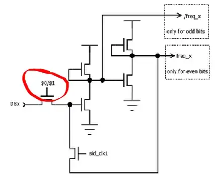

  1. In the section showing the diagram with the freq register bits, this says "The input is taken from the data bus for the lower 16 bits while upper 8 bits are grounded." However there are only 8 values from the Data Bus (DB0 - DB7). I don't know if they meant "for the lower 8 bits while upper 16 bits are grounded" and accidentally switched the 16 and the 8, or if each value from the Data Bus is being used for two values in the freq register bits (making 16).

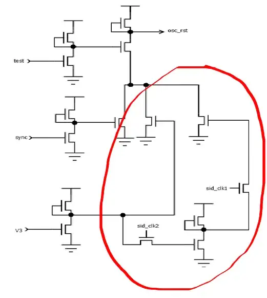

  2. Further down, in the section about the sum feedback of the oscillator, "The resulting sum is latched (inverted for odd bits) at sid_clk2" and I'm not quite sure what is meant by "latched." In the accompanying diagram, there are two different mosfets where the sid_clk1 and sid_clk2 lines are being fed into the gate terminal, but I'm not quite sure how this acting as a latch.
The answer is in the main text:
The input is enabled by the $0 line for the low eight bits and $1 for the others.
The drawing does not explain, but implying $0 symbol still open the channel to DBx, meaning inverted. Thus the 8bit data bus is multiplexed between low eight bits and the others. enter image description here
  1. Further down, in the section about the sum feedback of the oscillator, "The resulting sum is latched (inverted for odd bits) at sid_clk2" and I'm not quite sure what is meant by "latched." In the accompanying diagram, there are two different mosfets where the sid_clk1 and sid_clk2 lines are being fed into the gate terminal, but I'm not quite sure how this acting as a latch.
I believe the drawing just contracted the latch, unless there are way to build a UJT like latch. Otherwise it takes some size to construct a latch, like this, this and that.

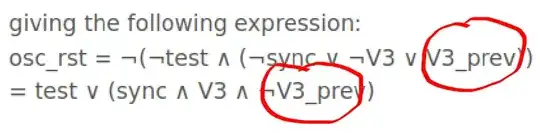

Otherwise, a bigger question arises about the latch. This stage can, possibly, avoid a latch, if the input registers and the last stage can latch. But the end stage must have a latch for V3_prev, but I do not see it. So, I insist :) that is contraction. enter image description here enter image description here
