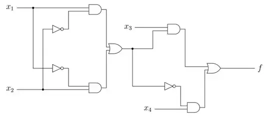

I understand that I should repreatedly use deMorgan's theorem until I am left only with NAND/NOT gates. This is easy when the starting function is an SOP/POS. However when it isn't, I get confused as to what my steps should be (both agebraically and graphically). Consider the function below:
whose circuit looks like this: enter image description here
I think I can do it algebraically but apparently it is possible to do it graphically (which should be the simpler approach). I can't get my head around doing it graphically, as the process is a little more involved than it is with SOP/POS. Can anyone give me a hand?

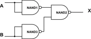

So graphically, replace each gate with it's NAND equivalent.
For an OR gate:
schematic

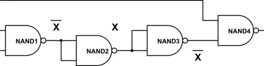

Remove double NOT gates (if they occur). NAND2 and NAND3 can be removed in the following schematic.

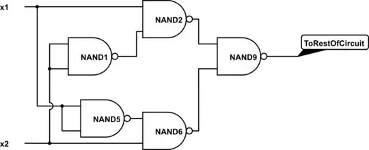

Edit...
First part of circuit:
schematic
simulate this circuit
In this circuit, NAND3 & NAND4 and NAND7 & NAND8 are redundant and can be removed.
schematic
