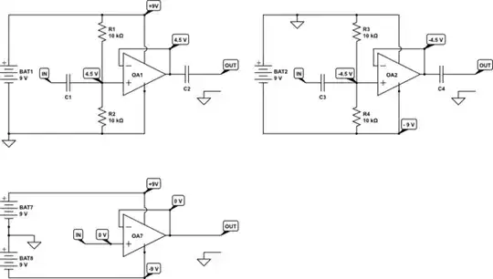

The following examples may help a little.
schematic
The three schematics above show various ways of creating a buffer pre-amplifier, for example, for a guitar. Typically these would be built in a diecast metal box with a PP3 9 V battery for power.
1) The first configuration shows the battery negative connected to ground. (Since the audio signal can go positive and negative we need to bias the op-amp input to half-supply using the resistors on the non-inverting input. Capacitors block DC at the input and output.)
2) The circuit would work exactly the same if powered with positive ground.
3) A third option is to use a dual supply. Here we see that we can eliminate all the DC bias related components at the expense of a more complicated power supply.
The important points to note are that we can set the ground at any arbitrary point and we give all voltage readings relative to that point.
Negative ground is most common and, for example again, would allow a shared 9 V power supply to be used on a bank of guitar effects pedals.
