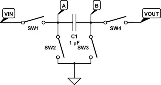

  1. Charge pumps and switching regulators: There are a number of circuit topologies that can produce a negative voltage given a positive supply. The simplest would be a charge pump, where a capacitor is alternately charged and discharged:
schematic
simulate this circuit
Assume, as before, that the ground symbol may be understood as earthing or the use of any reference convenient to you.
Initially, SW1 and SW3 are closed, causing the potential at A to rise above the potential at B. Then, SW1 and SW3 are opened, and then SW2 and SW4 are closed. Since A is below B, but A is now connected to ground (be it earth ground, your Arduino's GND connection, Mars ground, etc), hence B and VOUT are both below earth ground. With the addition of extra capacitors, and the use of fast semiconductor switches, this is something that is commercially realized as a practical way to produce voltages lower than your lowest supply.
With the appropriate safety precautions and appropriate components and measurement tools, you should be able to verify both of these examples and claims for yourself if you so desire.
