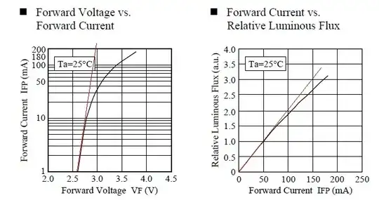

Secondly - actual brightness.
Using constant mean current, total light output falls for pulsed operation and is lower for increasingly low duty cycle! The effect is even worse for constant mean power !!
Both of these effects can be clearly seen by examining the data sheets of target LEDs. Luminous output per current curves are close to straight lines but curve towards decreasing output per mA as current increases. ie doubling current does not quite double luminous output. This decreasing rate of return accelerates as current increases. ie an LED operated at well below its rated current produces more lumen/mA than at rated current with increasing efficiency with decreasing mA.
Output (lumen) per Watt is even worse than lumen per mA. As mA increase Vf also increases so the Vf x I product increases at a faster rate per lumen than just I does. So, again, maximum lumen/Watt is achieved at low mA compared to rated mA and lumen/Watt efficiency improves with decreasing current.
Both these effects can be seen in the following graphs.
These curves are for the utterly marvellous [tm] Nichia NSPWR70CSS-K1 LED mentioned below. Even though this LED is rated at 60 mA absolute maximum and 50 mA continuous max Nichia have kindly specified it's performance up to 150 mA. Longevity at these current is "not guaranteed". This is about the most efficient <= 50 mA LED available. If anyone knows of any with a superior l/W at 50 mA and in the same price range, please advise!
I use the Nichia "Raijin" NSPWR70CSS-K1 LED in several products. This started life as an 30 mA LED but was uprated to 50 mA by Nichia after testing (with reduced lifetime of 14,000 hours). At 50 mA it delivers about 120 l/W and at 20 mA about 165 l/W. The latter figure puts it amongst the very best real world products available, although recent offerings are now exceeding this value at well below rated currents.

There seems to be a lot of misinformation around this area. Some say there is a visual effect that pulsing light is perceived brighter than its average level. As far as I can tell, there is some disagreement about this but it applies to rather slow flashing such that the persistance of vision carries the brightness between pulses. This is in the range of a few Hz to low 10s of Hz. I'm not sure there is a consensus about whether this is really perceived as brighter, or that its only more attention getting.
Fast flashing such that the light looks steady (a few 100 Hz) apparently does not increase perceived brightness. What you perceive is the average brightness. That means that a fast flashing LED is actually less bright at the same average power. LED brightness is roughly proportional to current, but higher current also causes a larger forward voltage drop. 10mA continuous and 20mA for 50% at 1 kHz will look pretty close to the same, but the latter will take more power since the voltage drop at 20mA will be higher than at 10mA.
LEDs brightness is mostly proportional to current, but not completely. It does fall off a bit usually with current, but for most indicator type LEDs this effect is so small as to be unnoticable. Humans perceive light intensity logarithmically. A factor of 2 looks like a small but clearly noticeable step. 10% is impossible to notice except in direct comparison.
High power LEDs used for lighting are pushing limits in a different way and exhibit more falloff with higher current. Maximum efficiency and maximum brightness are not the same thing. This difference is enough to matter in demanding applications. This is where you have to check the LED datasheet carefully. High power lighting LEDs usually have figures for brightness as a function of current, and you will see this tail off a bit at the high end. Also note that for those LEDs the instantaneous max current is closer to the average max than for small indicator LEDs. A lot of this has to do with temperature and heat management.

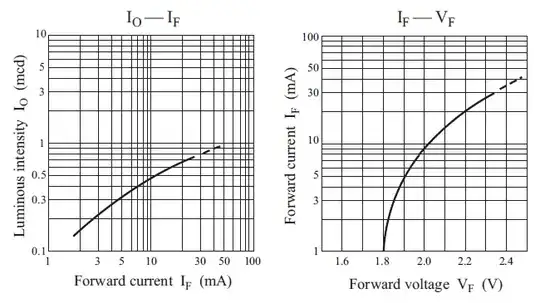

I've always learned and been convinced that LED current above nominal (often around 20mA for a common LED) will cause a higher luminosity, but less than proportional, and that it's not worth the current to do so. If this is the case pulsing won't get you more brightness. Suppose a LED with 0.45mcd @ 10mA, and 0.9mcd @ 40mA. Pulsed at 40mA with 25% duty cycle will give an average current of 10mA, and an average luminosity of 0.225mcd, that's only half the luminosity we'd get at 10mA continuous.
I didn't make up these figures. They can be found in the Panasonic LN222RPX datasheet:
I want to make two notes here:
  1. half the value seems like a big difference, but you'll have to remember that our eye perceives light intensities logarithmically; if doubling the intensity is 1 step then the difference between a dimly lit room (10 lux) and bright sunlight (100 000 lux) is only 13 steps. One step will be less noticeable than the numbers suggest.
  2. There's also the other graph, forward current vs forward voltage. Like for any other diode the voltage increases with increasing current. That means that power dissipation in the LED will increase more than proportionally with rising current.
If we stop here we could conclude that pulsed current is worse than continuous current, luminosity-wise and power-wise. BUT!
Kevin came with this graph from a Kingbright datasheet:
That curve is damn straight! For this LED (and others from Kingbright I checked) luminosity is perfectly linear with current, so pulsing should give the same result as continuous current.
conclusion
Apparently not all LEDs are made equal. While it makes no difference whether you pulse or not for some LEDs pulsing may give worse performance for others. However, I haven't found LEDs where performance increases when pulsing.

    I think it's not so much that some LEDs have linear brightness as a function of current whereas with others it tails off at high current. I think all LEDs do this, but for some the normal operating range is in the low linear region. I think Kingbright dumbed it down to a straight line because at 30mA that LED sees little falloff. If you could run it at higher currents I'm sure there would be falloff, but there are other limitations to prevent you from doing that, or more likely that Kingbright doesn't want to bother specing at. – Olin Lathrop Jul 29 '11 at 15:53
    @Olin - I see what you mean, but for the Kingbright it's perfectly directly proportional over the full DC range (30mA is Absolute Maximum DC current), and the Panasonic doesn't show this even at low currents. – stevenvh Jul 29 '11 at 16:02
    I suspect Kingbright simplified the data. – Olin Lathrop Jul 29 '11 at 17:05
    Ouch! That goes right against my Beliefs that a datasheet should be correct or should not be at all! :-) – stevenvh Jul 29 '11 at 17:11
