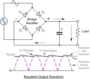

What you need is a rectifier, followed by a capacitor (to flatten out the rectified voltage). You can use a rectifier like in your Maplin link, or use discrete diodes.
bridge rectifier
1A diodes like 1N4001 are standard and will do nicely for a few standard LEDs. For the capacitor I use 2000uF/A as a rule of thumb, so if your LEDs consume 100mA you could use a 220uF/25V electrolytic capacitor. Be sure to place the capacitor correctly; it may explode if you reverse it.
The DC voltage will be about 15V (\$12V \times \sqrt{2} - 2V\$ ), so depending on the type of LED you're using it's a good idea to place a number of them in series, otherwise you'll have a big voltage drop over your series resistor = less efficient.
