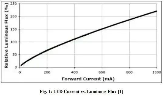

To answer your question you need to look at the relative luminous intensity vs. forward current on the datasheet. If it's linear then using PWM at \$n\$ times continuous reference current for \$ \frac {1}{n} \$ duty cycle will result in the same light output.
For the LED shown in Fig 1. indicates that there will be some reduction in light output if the current is pulsed as described in the previous paragraph.

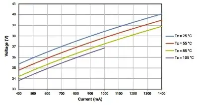

The forward current is only one factor in the wattage. Forward voltage is the other. You need to look at both factors.
All LEDs have a range (min typ max) of emitted flux at a specific current.

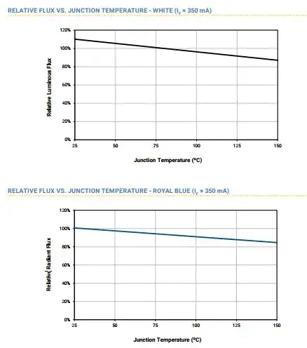

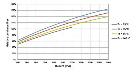

When comparing LEDs you cannot just look at the Relative Flux vs. Current but also factor in the forward voltage at the target current and temperature.
Also you must be aware the relative flux curves can be Luminous (Photometric) or Radiant (Radiometric).
Forward Voltage and Temperature
Forward Current and Temperature
Luminous and Radiant
