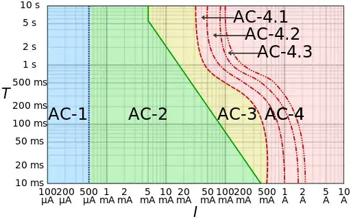

Wikipedia has a nice graph:
Log-log graph of the effect of alternating current I of duration T passing from left hand to feet as defined in IEC publication 60479-1.
AC-1: imperceptible
AC-2: perceptible but no muscle reaction
AC-3: muscle contraction with reversible effects
AC-4: possible irreversible effects
AC-4.1: up to 5% probability of ventricular fibrillation
AC-4.2: 5-50% probability of fibrillation
AC-4.3: over 50% probability of fibrillation
