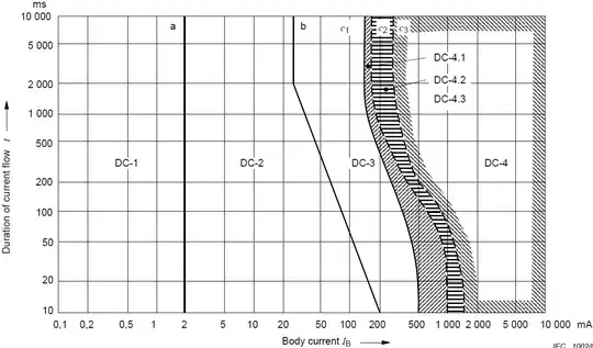

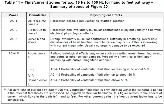

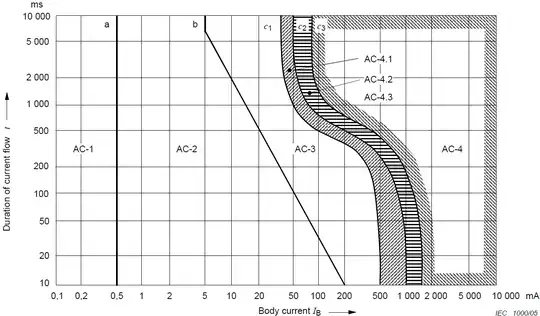

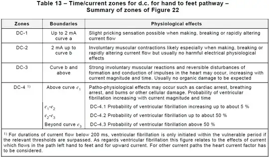

Of course and it is disciplined by different standards in different countries. I am used to IEC standards, so IEC 60479-1 is the reference for current-duration limits, distinguishing between perceivable intensity, peripheral muscular effects, more serious effects, e.g. on heart, injury, death. See IEC 60479-1 Figure 20 and 22 below for ac and dc systems, respectively, and Table 11 and 13, again for ac and dc, for interpretation. enter image description here enter image description here ... enter image description here enter image description here

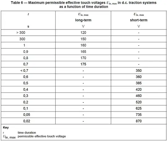

Calculation methods are more or less all in agreement, but standards may indicate different scenarios, different assumptions. This is what distinguishes applications: for residential applications the IEC 60364-4-41 may be more restrictive than EN 50122-1 for railways; for equipment, depending on use and the desired safety level you might have IEC 61010-1, IEC 60950, etc, instructing differently on the type of safety case and analysis they deem appropriate. An example of differences between parameters used for calculations is the assumed resistance for the victim: depending on hand touch voltage, step voltage between feet, likely wet environment, worker with good protecting equipment, skilled and in good health, etc.
To simplify, if limits only are considered, we may have different voltage-time curves, where lower voltages are tolerated for longer times. EN 50122-1 tables for ac and dc systems follow.

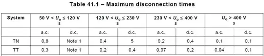

IEC 60364-4-41 assumes typical LV voltage levels and 50/60 Hz, thus giving a smaller range of tripping times (Table 41.1). They also specify on which current level a circuit breaker for leakage to ground (RCD, residual current protective device) shall trip: as said, 50 mA may kill you, thus 30 mA or less are normally adopted.

  • Actually I was specifically interested in short duration D.C. voltage, not high frequency AC. – Tom Sep 04 '17 at 16:00
  • @Tom. I edit the answer and include also the 60479-1 figure 22 for dc. In reality, a short pulse has a high frequency content, so at a first approx the expected behavior is similar. I have no other info on short pulses effect. – andrea Sep 04 '17 at 16:22
