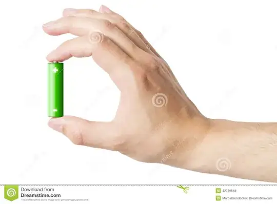

V does equal IR... Have you ever picked up a 1.5V AA battery like this? enter image description here
If the resistance between the terminals, was say 10 Ohms then we would potentially have 0.15 amps flowing... getting close to that "heart stopping 0.2amps" right?
Well, the thing is that the current is always going to take the shortest (lowest impedance) path, which in this case would be from the second finger to the thumb, which is a long way from the heart.
According to this article https://www.ncbi.nlm.nih.gov/pmc/articles/PMC2763825/ The resistance of dry skin is about 100,000 ohms and "internal body resistance" is about 300Ohms..
So putting these two facts together: 1) resistance of skin is quite high 2) current will take the shortest (or lowest impedance) path between two points
we can see that being short by a taser is not likely to stop the heart (unless the probes end up either side of it).

  • The lowest impedance path between the two taser prongs is unlikely to be through the heart. I thought the picture helped show that? – AugustCrawl Mar 05 '18 at 04:27

  • Which aspects of the question are unaddressed by the answer? – AugustCrawl Mar 05 '18 at 04:34
  • Current always explores *ALL possible paths, not just the shortest or the lowest impedance. – analogsystemsrf Mar 05 '18 at 04:47
  • @analogsystemsrf but when people have been hit by lightning, the current can be seen to have chosen the path of least resistance - as evidenced by the burn marks, but if your assumption is true then they should have an even burn pattern over all the skin surface... "Current always explores *ALL possible paths" – Solar Mike Mar 05 '18 at 04:52
  • @SolarMike The current through a path is inversely proportional to the resistance of the path. – user253751 Mar 05 '18 at 05:03
