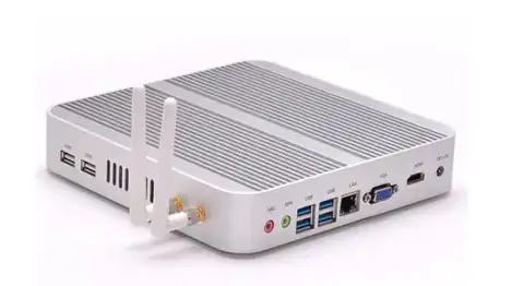

I used put some electronic circuits together in a plastic box, with a DC power jack attached to the box for a 24V dc supply to my circuit. Everything works fine. However i now plan to put all the circuitry into a metal chassis. I have heard that every metal chassis need to be grounded to the earth for safety reason. I searched online for more info but mostly are AC to the metal chassis box, which i knew it is just connecting the metal box to the 3rd prong. But for my case, can someone please tell how to ground the metal chassis with DC voltage input? I attach some images for understanding. I tried to make something like a mini PC with metal box shown in figure. Are those mini PC's metal box grounded as well?
what i want to do example of this
