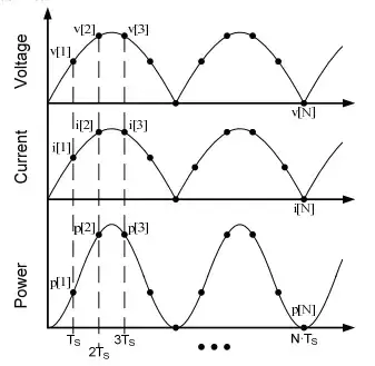

In a single phase meter measurement, the power is being measured by using the instantaneous power which is p(t) = v(t) * i(t). But as we need to sample the voltage and current to get the power, hence it need to be calculated by using this formula:
So is this formula can really measured the real active power without considering the phase angle between V and I? As we all know that active power, P = VIcosθ.
So what is the difference between apparent power measurement, S=VI and active power measurement if the P = VIcosθ is not being implemented?

Instantaneous Volts multiplied by instantaneous Amps is true power and no compromise and when micros implement this they are doing it exactly the correct way.
VI x power factor may not be true power because hardly ever is the voltage waveform or the current waveform truly sinusoidal and only when V and I are truly sinusoidal can RMS Voltage multiplied by RMS current multiplied by power factor = v(t). i(t).
Here are several examples of voltage and current waveforms shifted in phase to each other: -
The first picture is when v and i are in phase and power is maximum. Note also the example when v and i differ by 90 degrees (bottom left) - power is zero (as you would expect) but, if there is any harmonic distortion, VICos(phi) will be inaccurate.
