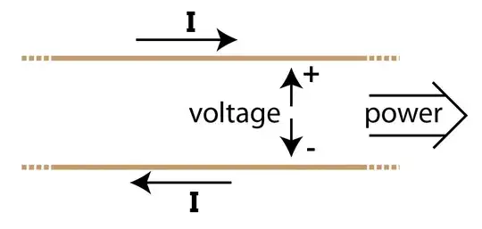

The output from a current transformer contains no information of the direction of the power flow. The direction of the power flow can be decided if one has at the same time available the polarity of the momentary voltage between the wires ( 2 wires assumed) and the directions of the currents in the wires at the same moment of the time. The currents in the 2 wires are assumed to be as many amperes, but to have opposite directions as Kirchoff's current law says
The rule The power flows at a certain moment just to the direction of the current in that wire which has at the same moment of the time the plus pole of the voltage between the wires:
If the load is resistive the momentary AC current direction changes just at the same moment as the voltage direction, so the power flow direction stays the same.
Reactive loads take current so that there's a phase shift between the current and voltage, so the power flows a part of the AC cycle towards the load and a part back to the voltage source.
A practical wattmeter measures at the same time the voltage between the wires and the current. It averages the momentary power, but it can show negative value if one swaps either the voltage measurement wires or current measurement wires. That's because the momentary power is the momentary voltage and current multiplied. Change one's polarity, the polarity of the power changes.

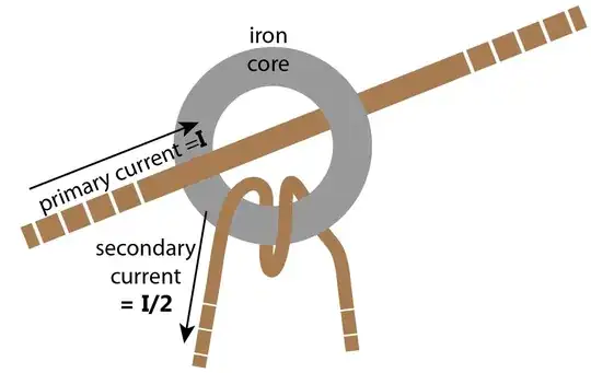

Current transformers are used if the current is too high to be measured directly or if one doesn't want to break one of the wires to insert the current measurement device. AC current clamp is actually an easy to insert current transformer plus a meter.
Here's a drawing how the momentary primary and secondary current directions are related (It's based on the Lentz Law of induction):
It's drawn as very loose to show the winding direction. A practical current transformer should have markings for the directions because the winding direction is not visible. Unfortunately the markings vary and they can be unclear, so one must measure the direction if he wants the polarity be surely valid for power meters. It can be done for ex. with a battery and voltmeter. See it here: https://www.quora.com/What-is-the-checking-of-CT-polarity
