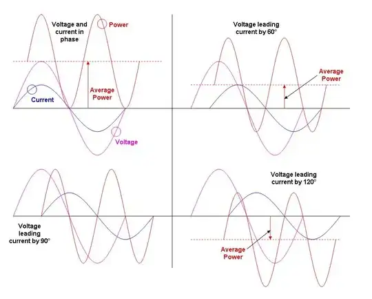

First of all consider this picture: -
It paints 4 scenarios all of which apply to this question: -
  • Top left shows voltage and current in phase and the multiplication of voltage and current waveforms produces a power waveform. Note that the power waveform has twice the frequency of the voltage and current hence, it's not usually meaningful to represent it as a phasor (and certainly not useful if you have other phasors representing voltage and current). The average power is P.
  • Top right shows voltage leading current by 60 degrees - note that the average power (P) has reduced but, the power waveform has the same shape, frequency and overall peak-to-peak magnitude. In this scenario we can start to realize what the apparent power is. Basically, S is half the distance between peak and trough of the power waveform and, in fact S = P in the top left scenario.
  • Bottom left is when a purely reactive load is connected to a voltage source. The power waveform has an average value of 0 watts (P = 0) but, apparent power (S) remains the same as the previous two examples.
  • Bottom right is likely to be encountered when a motor turns into a generator and pushes real power (P) back to the voltage source. In other words, there is real power (P) but it is negative.
