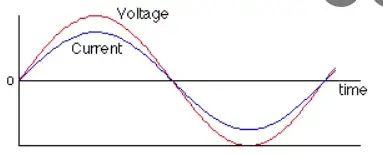

Suppose I have a single phase system and I have a sensor attached to to measure both voltage and current. The sensor samples for 50 kHz and the data is saved to a file.
When we then graph out the file we get something like this:

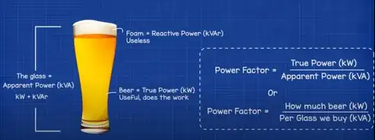

In the beer analogy, power factor is equal to true power multiplied by apparent power. Since the units are in kilowatts I suppose we have to multiply the voltage reading with the current reading.
What is then the result when we multiply the current and voltage data? Is it true power? Apparent power?
I doubt that it is apparent since I have read that establishments are billed for power factor. If the result is the true power, where is the reactive power on the graph? If the result of the multiplication is already the apparent power, then is the meter incapable of reading reactive power? I don’t think so since there are digital meters and they should have information like the graph above.

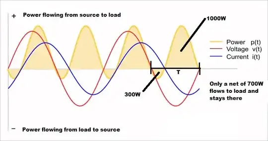

I find the most illustrative way is to get an out of phase V and I graph, and multiply them together to get instantaneous power graph.
enter image description here Modified from: https://learn.openenergymonitor.org/electricity-monitoring/ac-power-theory/introduction
In the power graph, everything is real power flowing in one direction or the other at any point in time. You can see sometimes positive, sometimes negative.
Here is the illustrative part:
Add up (integrate) all the positive parts. That's all energy flowing from source to load. Dividing that by your time interval T gives you the power going from source to load.
Add up (integrate) all the negative parts. That's all energy flowing from load to source. Dividing that by your time interval T gives you the power going from load to source.
It's all real power flowing in the end, but not always is it being dissipated to do work. The difference between the two tells us the real power actually being supplied or generated.
You can see over time some power just flows to the load and back again, doing no work but still consuming ampacity. This is the reactive power. It's the power flowing from source to load which has an equal amount of power flowing from load to source with which to cancel out.
If I have 1000W of real power flowing to the load over time interval T, and 300W of real power flowing back to the source over T, only 700W of real power is dissipated/consumed by the load to do work. The 300W flowing back and forth is the reactive power.
If you average the power graph over some time interval, to get a single average power number, that is the same as the real power (or net power) delivered or generated.
Apparent power is the maximum real power delivered we would get if we fiddled with the phase alignments and is just used as a reference number (the theoretical best). Power factor is a measure of how close we are to that number with our power delivery.

  • Thank you i find your explination quite helpful, i do still have some questions though. so the negative power is actually power that is "returned" to the grid am i correct? – Jake quin Jul 04 '21 at 18:41
    @Jakequin It is the power flowing in the opposite direction of what you defined as positive. By convention, positive usually means source to load, so yes. – DKNguyen Jul 04 '21 at 18:42
After averaging your waveforms of \$v\cdot i\$, the result is both true power and apparent power because, the voltage and current waveforms appear to be exactly in-phase. Apparent power is when you use an RMS reading voltmeter and an RMS reading ammeter and multiply the two RMS values together. Only when power equals unity does true power equal apparent power (like the example in your question).
No, power factor is true power divided by apparent power.

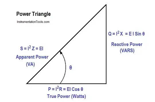

Additionally, the beer glass analogy has to be treated with some caution because the level of foam plus the level of beer aren't linearly related to their equivalent powers. You need to use the power triangle to understand that and not some beer-driven (and quite possibly drunken) linear addition: -
Image from here.
Pythagoras is the trick and not a linear sum of quantities in a beer glass (despite it being a very, very nice drink when watching certain UEFA Euro quarter finals on the TV and usually at all other times except breakfast).

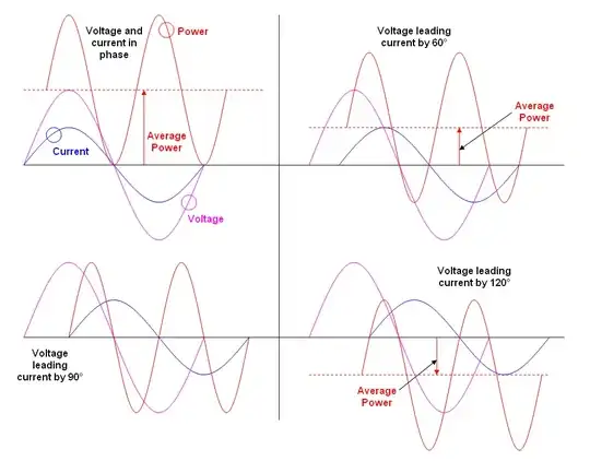

Footnote about power waveforms based on \$v\cdot i\$ and different phase angles: -
Picture taken from this answer and this answer and this answer and this answer and this answer and this answer and this answer and this answer to name a few.
I suggest you read them to get a wider perspective.
