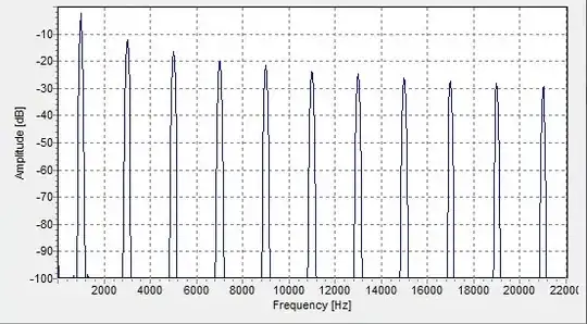

What about your square wave? Let's have a look at the plot of a square wave frequency components (also called spectrum):
(source: wikipedia)
That's a 1kHz square wave: as you can see the function plotted is very high at 1kHz, but also at 3, 5 and so on... And (trust me) the height of the peaks goes down as 1/f, that's slow. And please note I did not made any assumption on whether the wave is going or not below zero.
So your square wave is far, far away from being DC.
Now to your second question: that's a completely different one. If and only if your square wave amplitude is very very small compared to other signals you have around you can say "well let's just pretend it's not there". But that's not your case, your square wave is the signal you want to amplify. And as you just learned that's not DC at all... You better look carefully at the specs of the op amp you are going to choose then.
