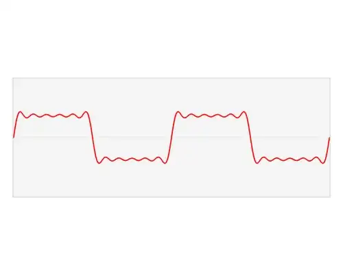

    The capacitor discharging is a DC signal with a set of infinite AC lower harmonics summed together, which produces the asymptotic fall-off. Much like a square-wave is really the product of an infinite set of higher-order harmonics, everything is fundamentally a offset + harmonics of some sort. Hell, you can even produce something that looks like DC with the right infinite set of harmonics. – Connor Wolf Dec 21 '14 at 13:52
  • Basically, you can derive DC from AC with the right infinite series, but you cannot derive AC from DC. Therefore, representing things in terms of AC is much more useful then DC terms, which can never fully describe a system where anything changes. – Connor Wolf Dec 21 '14 at 13:53
