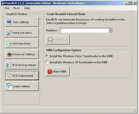

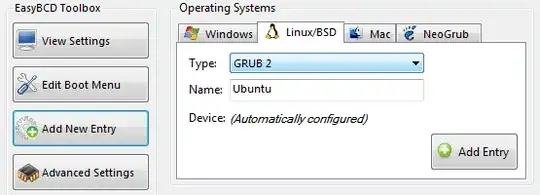

If you want to use the Windows boot loader to dual boot instead of using grub2 you can do so using EasyBCD (its free for private use).
* Step 1 *
Open EasyBCD and on the BCD Deployment tab press the button after selecting the correct option for your operative system (WindowsXP / Windows7)
* Step 2 *
On the Add New Entry tab select Linux/BSD, from the dropbox select Grub2 type and give the new entry a nice name (Ubuntu will suffice). Press Add Entry.
If all went well on your View Settings tab you can check if the new Ubuntu entry is there.
Reboot and you will be greeted with Windows boot menu and it should now have an option to boot to Windows and one to boot in to Ubuntu.
If later on you want to remove Ubuntu you can simply remove the Ubuntu partitions using the Windows disk manager and use EasyBCD remove the Ubuntu entry from the MBR.
