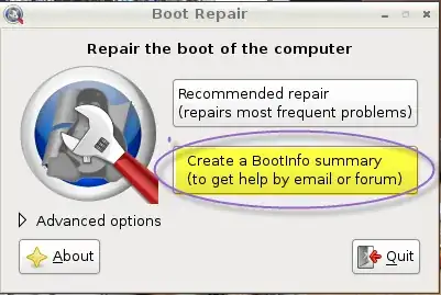

  4. The tool will now scan your system and (eventually) display the window shown in the image below. Click on the Create a Bootinfo summary box/button. This will collect information about your system's boot configuration, but will not make any changes.
    Initial Boot-Repair Window
  5. When the bootinfo summary has been created, boot-repair will display a message containing a URL which should look like this: http://paste.ubuntu.com/123456/.
