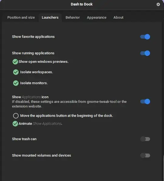

If you are using the Dash to Dock extension, you can click on Isolate Workspaces to show the apps running in only the specific workspace.
You can find this option in the Dash to Dock settings:
  1. Go to the Extensions app on your Ubuntu 20.04.
  2. Click on the settings button in front of Dash to Dock.
  3. Then go to Launchers tab and enable Isolate Workspaces.
Here is a screenshot of the Dash to Dock Launchers tab:
