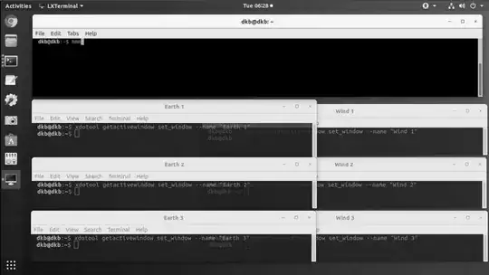

The following animated gif will illustrate using another "master" terminal, located at the top of the screen in the image, to issue code to minimize or maximize a particular group of windows.
To do so, I added the following functions to my ~/.bashrc:
mmm(){
    echo "enter KEYWORD" && read KEYWORD && xdotool search --name --onlyvisible "$KEYWORD" > /tmp/tmp.txt
xwn() {
    while read p; do xdotool windowminimize "$p"; done </tmp/tmp.txt
xwx() {
    while read p; do xdotool windowactivate "$p"; done </tmp/tmp.txt
  • mmm uses xdotool to search for the string "KEYWORD" provided by the user. "earth" in this example, is common to one group of terminal windows to be acted on. xdotool produces their window identifiers which is directed to a temporary file.
  • xwn uses xdotool's windowminimize action to minimize the windows specified in the temporary file.
  • xwx uses xdotool's windowactivate action to maximize the windows specified in the temporary file.
  • Note that, depending on what else has been done, it maybe necessary to run mmm immediately before xwn or xwx.
Using xdotool to minimize/maximize groups of terminal windows
I had to use mogrify -type Grayscale -depth 7 *.png to scale down the size of the gif.
