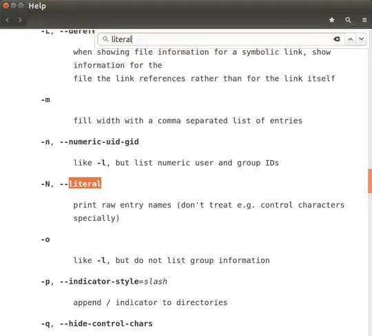

GUI Methods
If you have Ubuntu Desktop version installed you can search graphically.
Gnome Help
Gnome help uses yelp program. Instead of typing man ls for the CLI man page you can type yelp man:ls and view in GUI window:
yelp man:ls.png
Once loaded you can use Control + F to search.
