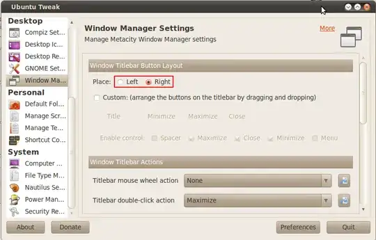

If you have installed Ubuntu Tweak, go to Window Manager and change the Place from left to right or vice versa. This will change all windows' Titlebar button layout, not only gnome shell.

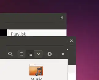

Gnome version 3.10, Using 13.04 and 13.10
If you upgrade Gnome to 3.10 you may notice a change in window decorations.
Gnome version 3.10 is moving towards Client Side Decorations(CSD for short) in all of the Core apps.
In these apps the close button is integrated into the program window and does not use the normal window decorations.
As Web Upd8 states:
Another pretty major change in the latest GNOME 3.10 is the introduction of "header bars" or "client side decorations". These decorations use the GTK+ toolkit and theme engine:
As you can see, the close button is now displayed inline with the toolbar which saves spaces but unfortunately it also creates an even bigger discrepancy between GNOME core apps and the other applications, because only the core GNOME apps use these client side decorations.
Some applications that have CSD may respect the environment variable GTK_CSD=0 (a variable used to "try out" CSD in eariler gnome versions with =1) for more information about Environment variables: https://help.ubuntu.com/community/EnvironmentVariables especially the section: Launching desktop application with an environment variable to experiment with programs adding something like this to a launcher:
Exec=env GTK_CSD=# gedit
substuting "#" with 1 or 0 for on and off, and gedit with program of choice
However it seems with Nautilus in 3.10 the variable Does not work.
Simply put:
In 3.10 it's going to have a close button at the top right no matter what[...]

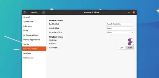

In Ubuntu 18.04 and later there are multiple options:
  1. You can now just install GNOME Tweak Tool (which is a helpful tool anyway) from the Software Center or by running in a terminal:
    sudo apt install gnome-tweaks
    and in the menu Window Titlebars change Placement to Left.
    Tweaks

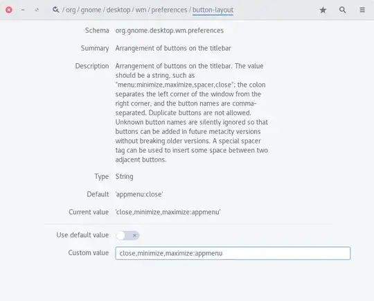

17.04 and 17.10 (Gnome 3.22)
The beginning is as in this answer: https://askubuntu.com/a/113995/286561
You will need dconf-editor, which is part of the dconf-tools package. Install it first:
dconf-tools
Start dconf-editor:
Alt+F2 → dconf-editor
But the key is /org/gnome/desktop/wm/preferences/button-layout, the default is: appmenu:cloe, I've changed it to close,minimize,maximize:appmenu. (appmenu doesn't seem to have an effect.)
I've you want to do it on the terminal you can do it as pointed out in this answer: https://askubuntu.com/a/377811/286561
gsettings set  org.gnome.desktop.wm.preferences button-layout 'close,minimize,maximize:'
