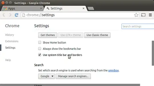

I believe there is an option to use "System title bars" under the settings on the "Hamburger Menu" on the upper-right hand corner in Chrome. Navigate to settings, the same screen where you would select for chrome to use the GTK+ theme, and the setting is in there.
As shown in this picture:

The problem with @Jbuch14 answer is that it adds an extra bar on top of everything, so it's not a real solution. I dont want any extra bars, I just want Chrome's own buttons to be at right side. How to do it?
edit: Ok I figured it out! Instead of enabling "use system title bar...", you DISABLE it, and then run command
gconftool-2 --set /apps/metacity/general/button_layout --type string ":minimize,,maximize,close"
and voila! No double top bar, and buttons are Windows-style at right.
