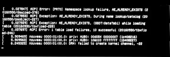

I'm trying to install Ubuntu on my GL553VE laptop. I'd like to dual boot it. Whenever I try to install it or just run it without installation loading screen just freezes. At one of my tries I received this error message:

I've come across this one. You can check the answer in this link: Is nomodeset still required?
...And if you happen to later have the awful display tearing issue, you can check this other link: Nvidia drivers - Unable to check "Force full composition pipeline"
Hope these help you!
I got past the installation by using acpi=off in the installation parameters.
Touch does not work after the installation though.

I managed to install Ubuntu 18.04 on my ASUS RoG GL553VE (with dual-boot). These are the steps:
  1. Boot Live Ubuntu then Install.
  2. After the installation successful, I forced the laptop to reboot, because somehow the installer hangs.
  3. Boot up the laptop, wait until the GRUB screen.
  4. On the default line (which is highlighted), press E.
  5. Add nouveau.modeset=0 at the end of the linux line - press F10 to apply it temporarily & boot.
  6. Login, then start the Software Updater, then hit the Settings button.
  7. Go to Additional Drivers, choose NVIDIA proprietary driver instead of the x.org ones.
  8. Reboot.
I hope this helps.

I had the exact problem with the same laptop. It's an issue with the Nvidia driver on Ubuntu. The solution to the problem is in this answer to the question
Once you get past the installation phase though, you will run into a myriad of other issues while attempting to install the 1050Ti drivers. I'm still struggling with that part, so can't really help out with that yet. Good luck!
