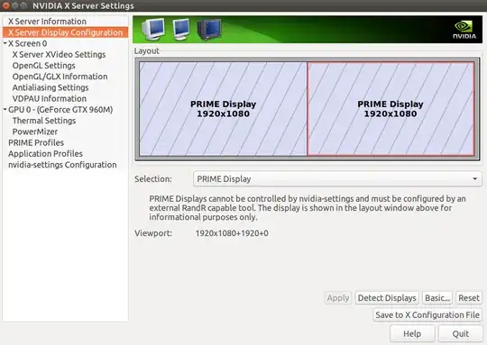

I feel your pain. I always have problems trying to figure out how to get rid of tearing on my laptops that have both an Nvidia dGPU (Dedicated GPU) and the iGPU (Integrated GPU).
I'm going to take a stab in the dark and guess that you're system is a PRIME system, in which case the composition pipeline options will not be available (even adding them manually to your xorg.conf file won't work - it'll probably just make your screen go dark).
I think what you're looking for (again, just guessing) is PRIME Synchronization - this is Nvidia's new way of syncing screens.

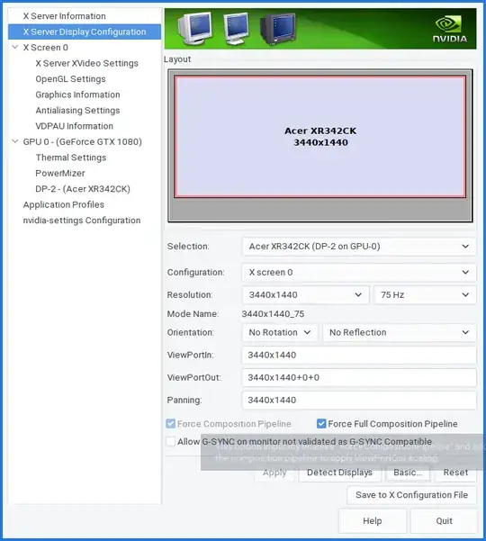

In the latest (as of writing this) Nvidia Binary Drivers 430.26 there is such option (of course I am assuming here that the driver is properly installed and works) :
But if it does not show up for You for some reason there is another way to enable it via xorg.conf file.
Here is how it looks like in my system:
Edit /etc/X11/xorg.conf file and the following code to the Screen section (note that there will be more options in Yours) :
Section "Screen"
    Option "metamodes" "3440x1440_75 +0+0 {ForceCompositionPipeline=On, ForceFullCompositionPipeline=On};"
EndSection
Save and then reboot system.
Another possible way is to use nvidia-settings :
$ nvidia-settings --assign CurrentMetaMode="nvidia-auto-select +0+0 { ForceCompositionPipeline=On, ForceFullCompositionPipeline=On }"
