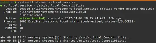

On newer Ubuntu versions systemd is used and /etc/rc.local is not loaded always by default.
Check if the Compatibility service is loaded with
systemctl status rc-local.service
screenshot
If it contains active (exited) your setting seems fine and you could have another error in your /etc/rc.local file (this could be a command that fails for example).
