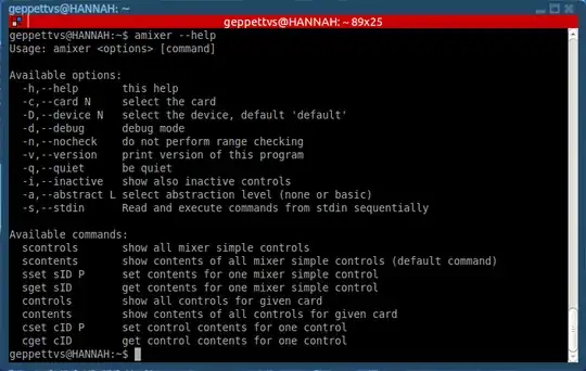

If you are using ALSA, amixer can be helpful for your script programming.
When dropping the amixer --help command in a terminal you will see something like this:

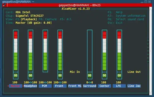

Depending on your soundcard, levels may be different than mine, but you can use alsamixer in the terminal in order to check which levels and which features in your sound card you can call in a command to set the volume as you wish.
In my example, with my principal sound card (I have 2: the embedded and a PCI audio card), levels are from 0 to 100, this way I can change the volume of a desired input/output in my soundcard by dropping in a terminal the next command:
