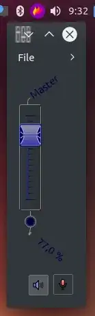

sudo apt install kmix
By default the actions on the tray icon don't affect the bluetooth speaker, until that speaker is selected as master channel (righ-click the icon, "Select Master Channel").
It shows no volume change pop-up on mouse actions on the tray icon (at least not in this LXQt).

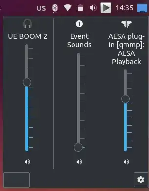

sudo apt install qasmixer
Resize the window and drag it close to the volume icon.
