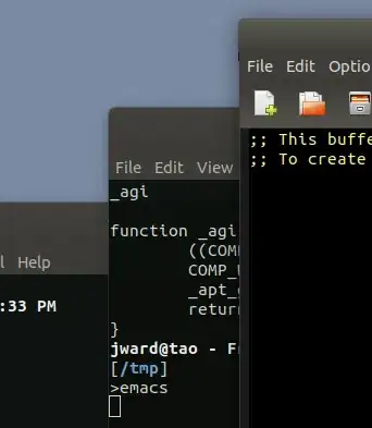

I don't really like that bright gray, here's my preference for ~/.config/gtk-3.0/gtk.css (rgba colors only worked in wayland for me, so I settled on #383838.)
terminal-window notebook {
  border: 1px solid #383838;
But that alone doesn't work for emacs, so I also add:
/* for emacs */
window#Emacs.background box#pane {
  border-style: solid;
  border-color: rgba(0,0,0,0.75);
  border-width: 0 1px 1px 1px;
Here's the pretty, subtle result:
nice subtle window borders
Bonus / note to self: you can test and tweak css using the GTK inspector, e.g.: GTK_DEBUG=interactive emacs (tutorial) - and a reference for how gtk CSS selectors work.
