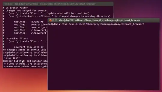

I seem to live my life in the terminal - many terminals in-fact.
I also love the Ambiance theme - but the new borderless windows does not provide the visual differentiation I'm used to (the same black windows appear to blend into each other).
Thus to my question - how do I add back the single pixel border for windows that is found in earlier Ubuntu versions?
I want to keep the Ambiance overall theme since this looks good and I dont want to swap to another theme.

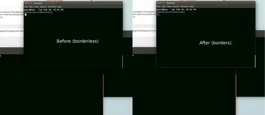

Building on Anders' answer, if you want a nice, subtle dark line instead of the default ugly bright/gradient line (just because you can use a gradient doesn't mean you should, Ubuntu!), edit /usr/share/themes/Ambiance/gtk-3.0/apps/unity.css like so:
Set the UnityDecoration extents like in Anders' answer:
-UnityDecoration-extents: 28px 1px 1px 1px;
Change the background-image to none in left/right, and change the background-color shade from 0.7 to 0.4 in left/right and bottom:
UnityDecoration.left,
UnityDecoration.right {
    background-color: shade (@bg_color, 0.4);
    background-size: 1px 70px;
    background-repeat: repeat-x;
    background-image: none;
UnityDecoration.left:backdrop,
UnityDecoration.right:backdrop {
    /* start color: mix of the top border color and bg-image gradient end */
UnityDecoration.bottom {
Optionally, adjust the 0.4 to your brightness preference.
After you change the files, you can either logout and log back in, or simply open the Appearance dialog and change the theme away from, then back to, Ambience.
Here's the result (may need to view at 100% to see the borders, they're only 1px thick):
Ubuntu Ambience Theme Borders

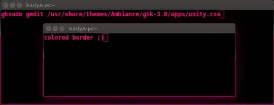

Do you like colored border?
  • Edit /usr/share/themes/Ambiance/gtk-3.0/apps/unity.css file and
  • Comment their current background-color value (/* shade (@bg_color, 0.7); */)
  • Then change the background-color to your favorite color(color with hex-code)
    in bottom, left and right (mine is #ff0080):
        background-color: #ff0080; /* shade (@bg_color, 0.7); */
  • Save the file and log out/log back in and see the magix.
