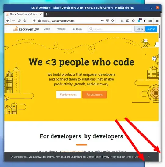

For 20.04:
sudo nano ~/.config/gtk-3.0/gtk.css
Then add/replace this code for decoration. It will add a 5px border around the window and as a bonus, it makes it slightly transparent:
decoration {
    border: 5px solid rgba(10, 10, 10, .3);
    background:rgba(10, 10, 10, .3);
