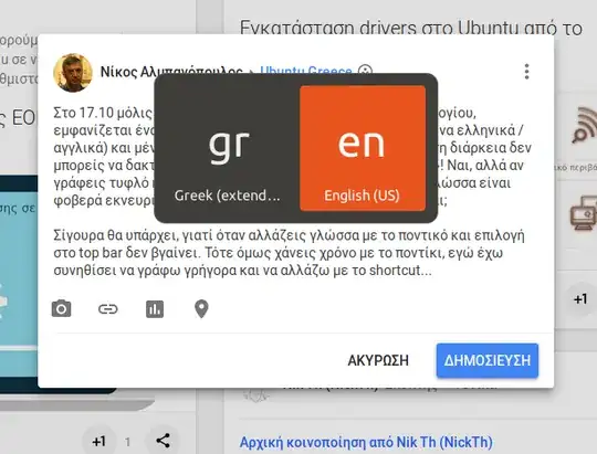

Since I installed 17.10, when switching language with the assigned keyboard shortcut I get this switcher "window" that obstructs me from typing for a couple of seconds. And yes, a couple of seconds is a huge amount of time when switching languages a lot.
huge focus-grabbing language-switching indicator
This happens both in X11 and Wayland but doesn't happen (the obstructive window will not appear) when I switch language by clicking on the lang indicator on top bar. Is there any way to tell this window "please go away"?

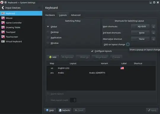

I know this is a very delayed answer and it might not be useful. But I wanted to share this with you guys. I'm using Kubuntu 22.04 and I chose Wayland. I get the same thing here but I disabled it by right clicking the language icon in the taskbar. Configure > Configure Layout. Uncheck the option that says: OSD on layout change. And you are good to go. No need to alter the shortcut, or do any scripting.enter image description here
I hope this helps.
