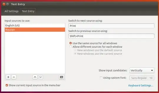

As possible duplicate answers state - this is almost impossible in the GNOME Shell.
But it is possible in Unity. It is still available for 18.04 LTS.
You can install it with sudo apt-get install ubuntu-unity-desktop.
Then setup your keyboard layout keys:
  • Switch to next source using Print
  • Switch to previous source using Shift+Print

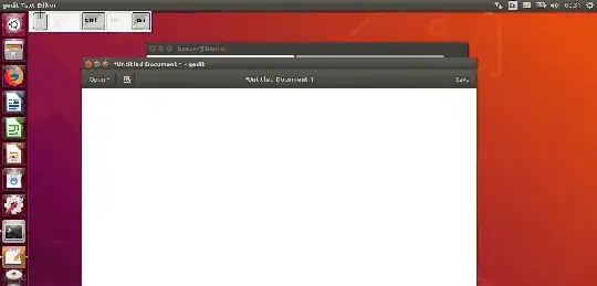

PrintScreen and Shift+PrintScreen on Ubuntu 18.04 LTS with Unity
It works as expected:
Screencast with PrintScreen as layout switcher
