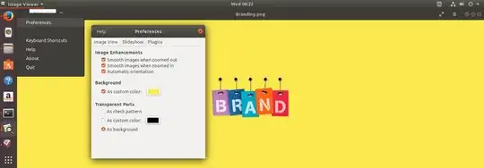

I've mixed the applications and this answer is not about gThumb. But I've decided to leave it here at the moment. This answer is about the application ImageViewer, that actually is called [1] EoG - Eye of GNOME.
You can change the background colour of ImageViewer through its settings: ImageViewer Menu > Preferences > Image View [tab].

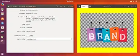

If you want to change the background colour within the application ImageViewer via dconf-editor go to: org > gnome > eog > view > background-color.
  • Where rgb(255,255,0) is the RGB code of the yellow colour [2].
Or use gsettings [3], if you want to change this setting via the command line:
  • to get the current value use:
    gsettings get org.gnome.eog.view background-color
  • to set a new value use:
    gsettings set org.gnome.eog.view background-color 'rgb(255,255,0)'
