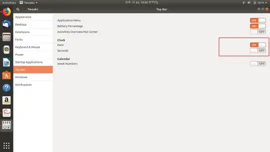

I want to show date in top bar using gnome-tweak-tool. I get the GUI solution How to show date in top bar of deskop in ubuntu 18.04 LTS?
I want to get the CLI solution so that I can add this in my post OS installation script.

Open Terminal and run
gsettings set org.gnome.desktop.interface clock-show-date true
to enable the option to show date in top bar.
