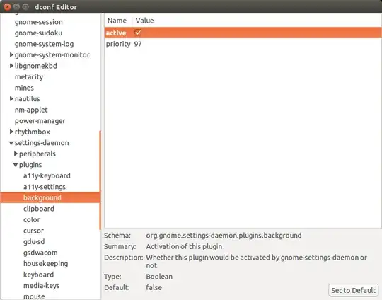

In my case this Ask Ubuntu answer solved the problem.
The org.gnome.settings-daemon.plugins.background setting had been disabled but I could not determine why. Once I checked this checkbox in dconf-editor and changed my wallpaper, it was reflected on the login screen.
dconf Editor
Dconf-Editor: ORG/GNOME/SETTINGS-DAEMON/PLUGINS/BACKGROUND
We can get the value of the above setting by running this command:
gsettings get org.gnome.settings-daemon.plugins.background active
We can change this value with the command:
gsettings set org.gnome.settings-daemon.plugins.background active 'true'

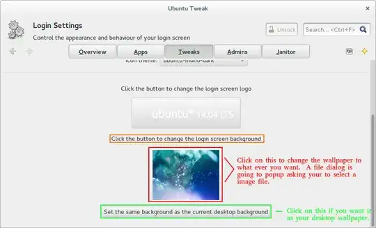

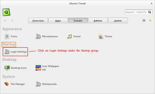

How to Change the LightDM wallpaper
  1. Install Ubuntu Tweak
    First Install Ubuntu Tweak Click here to download the .deb and install it though Gdebi, Ubuntu Software Center, ect... Or You can install it though the terminal by these two/three commands:
    wget https://launchpad.net/ubuntu-tweak/0.8.x/0.8.7/+download/ubuntu-tweak_0.8.7-1%7Etrusty2_all.deb
    sudo dpkg -i ubuntu-tweak_0.8.7-1%7Etrusty2_all.deb
    OR
    sudo add-apt-repository ppa:tualatrix/ppa
    sudo apt-get update
    sudo apt-get install ubuntu-tweak-tool

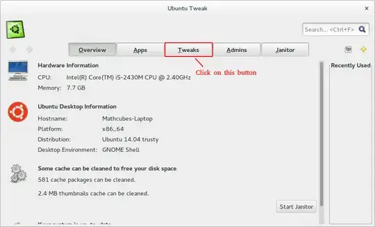

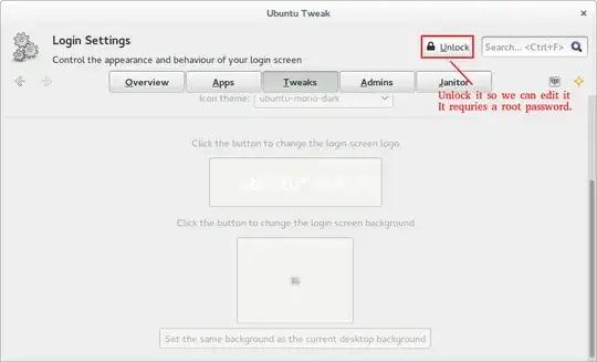

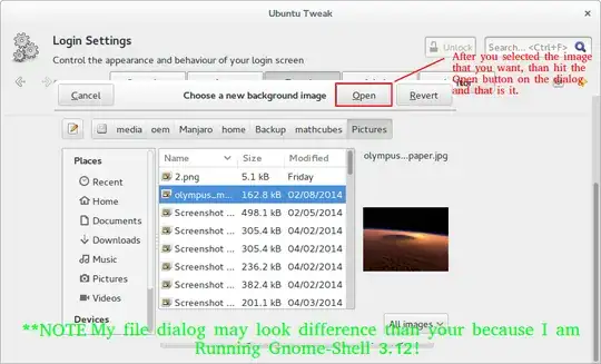

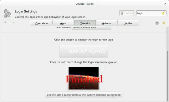

  2. Open Ubuntu Tweak
    and follow the steps shown in the images below:
