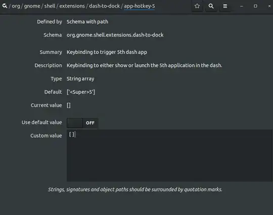

Install dconf-editor (sudo apt install dconf-editor) and open dconf-editor. Replace the keyboard shortcuts with empty brackets '[]' as shown in the screenshot.
Screenshot of how this is done for supr+5 keyboard shortcut

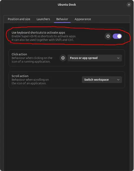

For Ubuntu 24.04
Open the "Extension Manager" for Gnome Extensions, click on the cog wheel for "Ubuntu Dock".
Then disable the "Use keyboard shortcuts to activate apps" setting:
