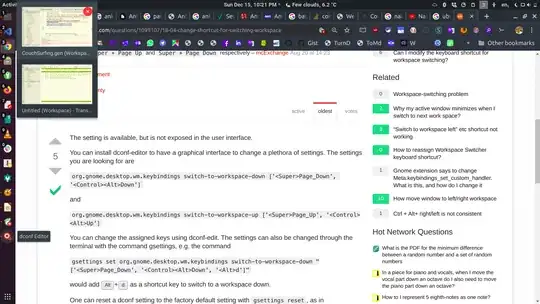

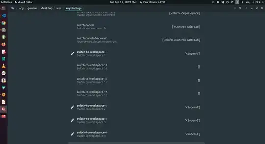

I followed the steps mentioned in: 18.04 Change shortcut for switching workspace - Ask Ubuntu, to change Keyboard shortcuts to switch to another workspace, as can be seen in the following picture:
Most of the times this works. But, sometimes this shortcut that I have set Super+1 and so on conflicts with the other shortcut: The icons on the dash or Ubuntu Dock (on the left edge of the screen gets switched) as shown in the following figure: (You can observe that numbers appear at the bottom of each icon.)

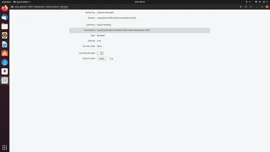

This command will disable the hot-keys behaviour.
gsettings set org.gnome.shell.extensions.dash-to-dock hot-keys false
This command will disable the showing of numbers.
gsettings set org.gnome.shell.extensions.dash-to-dock hotkeys-overlay false

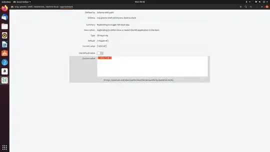

If you want to change the shortcuts for these behaviours.
Open the dconf-editor (if not yet installed, use sudo apt install dconf-editor)
change the values like for example: app-hotkey-8 from '<Super>'8 to '<Ctrl>8' or any valid shortcut your prefer.
