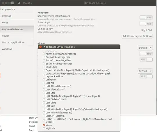

I have been using the Menu key since October 2017. One has to set it in the Gnome tweaks:
the menu option to change layouts in the gnome tweaks
as well as in "panel -> text entry settings" in the upper right corner of the screen.
