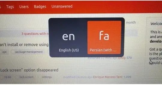

I am using 2 language keyboard layout Persian and when I press switch keyboard layout key, It shows language switch and delay about 1-2 sec before I can start to type again.
Is any possible way to remove this delay?
