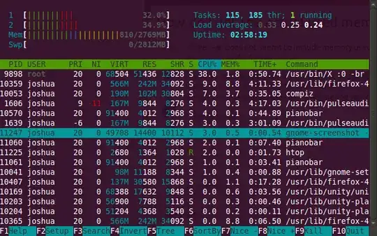

280
I think htop is the best solution.
  • sudo apt-get install htop
This way you will notice what programs is using most RAM. and you can easily terminate one if you want to. Here's a screenshot!
Alvar
  • 17,038

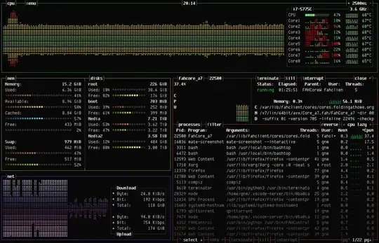

13
I just found this solution and it works very well, creating a graphical interface through the CLI:
# fixed link
git clone https://github.com/aristocratos/bashtop
cd bashtop
bash bashtop
Screenshot
colindaven
  • 104
